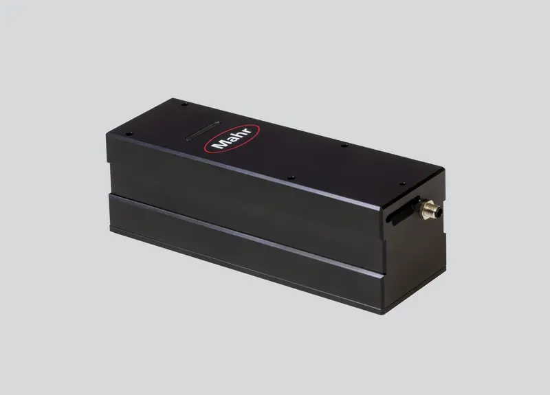

Small measuring device for a large range of applications
The MarSurf M 510 offers a measuring range of 1 mm with three variants in measuring lengths of 15 mm, 50 mm and 75 mm. You can use it to reliably and precisely determine the roughness and waviness of technical surfaces of workpieces of all kinds, for example shafts, camshafts, breather sealing lips, cylinder bores or metal sheets. You can easily install and set up the device yourself, as Mahr delivers it fully configured.
Suitable for use in the production environment
Other features ensure that the MarSurf M 510 can be used for a wide range of applications. Thanks to its vibration resistance, you can use the device in a production environment or in machining centers without any problems. The motorized lifting and lowering of the wand makes it a reliable and flexible companion for measuring surfaces. Another particularly practical feature is that it adheres to ferrous metal surfaces with the optional magnetic holder, allowing you to position and fix it as required.
Measuring device with numerous benefits
Customers benefit from many other advantages with the MarSurf M 510:
- The measuring device is the smallest free probe system on the market.
- Due to its small size and weight, the MarSurf M 510 is easy to handle and convenient to use.
- It offers standard-compliant measurement of waviness and large roughness values over a measuring length of up to 75 mm.
- You can test P, R and W parameters easily and conveniently with just one device.
- With more than 1,000 measuring programs, it can be used comprehensively.
- Thanks to Windows compatibility, the software can be flexibly controlled with a PC or laptop.
- Extensive accessories ensure even more application possibilities.
