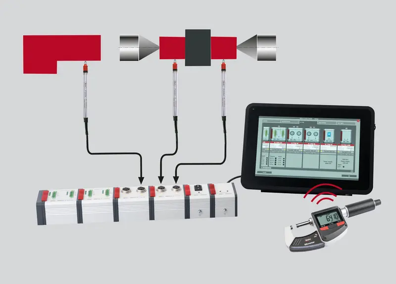

In contrast, the use of special measuring computers such as the Millimar C 1750 PC in combination with a customized measuring solution offers greater advantages with simple operation:
  • A measuring computer processes many individual measuring points by integrating measuring channels for different sensor types into a basic computer.
  • These measurement channels allow it to evaluate several measurement sensors simultaneously instead of a series of individual ones.
  • In addition, it provides the operator with a visual display of the acquired and evaluated measurement data.
  • Since it is networkable, its measurement results can be seamlessly integrated into modern production.
Thus, the measurement computer serves to display, acquire data, classify the results and control the overall measurement process while information is exchanged in the background.
