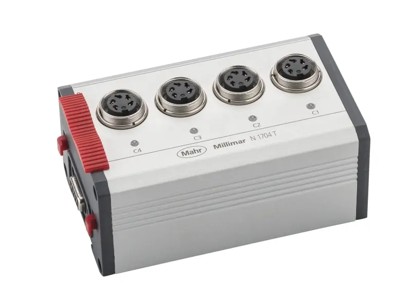

4-fold inductive module N 1704 M/ T/ U
This new module combines and improves the qualities of the N 1702 module: it combines four slots for inductive probes in one module.
If you need more than two slots for your transducers, the new module is already worth using; its more compact design saves you valuable space. In addition, you can save up to 22% of your costs by using the module – and in subsequent operation you will also have save another 50 mA of power.
The new module is available in three versions and is compatible with the Mahr, Tesa and Marposs probes.
Advantages of one module compared to two single modules:
- Space saving of 35 mm
- Cost savings of more than 20%
- Power saving of 50 mA
